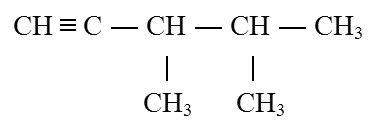

I'm not really sure how to name this isomer:
2,3-metyl-5-pentine or 3,4-metyl-1-pentine?
Because according to the rules I'm supposed to:
Find the longest C atoms chain;
Number the C atoms starting from the end where the radical(s) is/are closer to - so I'd have to start numbering from right to left.
BUT ALSO I have to number C atoms starting from the end where the triple bond is the closest - and in this case I'd have to number from left to right.
So I'm confused: how do I number the C atoms in this one?
Speaking of radicals I think I should combine not just pentyl, butyl, propyl, but as well metyl, etyl, right?

To be pedantic, neither is the correct name, but I think the second is closer to the truth. I believe that the yne has priority here.
Yes, you also have to take into account methyls, ethyls and protons, but there is not any isomerism here. Check your formulae for the ethyl, propyl and butyl radicals

I've checked with my teacher about that isomer and it's 3,4-dimetyl-1-pentine (or whatever's the spelling), because you have to start numbering from where the triple bond is closer to the end of the longest C atoms chain, because the triple bond is higher in the hierarchy than the radical.
