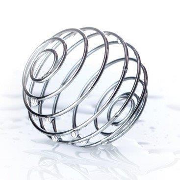

surgical steel is corroded oxidized by some presence of muriatic acid vapor in the environment?

"Surgical steel" isn't accurate enough. It can belong to very different families of stainless steel
https://en.wikipedia.org/wiki/Surgical_stainless_steel
The hard martensitic or ledeburitic stainless steels make cutting tools, possibly some prostheses. They definitely won't resist hydrochloric acid. Even a short exposure would collapse its future resistance to water, needing special cleaning.
The softer austenitic stainless steel, of "surgical" or marine composition (Aisi 316L or 17Cr-12Ni-Mo-blahblah) makes piercings and some implants. It resists hydrochloric acid in reasonable concentration at room temperature.

Do I clean bathroom with muriatic acid generate a muriatic vapor spread throughout the house corroding these metals?  vapor muriatic acid corrosion?
I refer to the surgical steel of the balls used in supplement mix shakers
