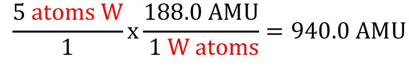

several things to cover here.  Let's start by taking a look at this image.
The first line is your work.  The next two are mine.  The color coding shows what's canceling.  I think it's outstanding that you're using factor label method (aka dimensional analysis) and I encourage you to continue doing so.  Your problem setup is excellent except for 1 thing.  What you converted "to".  The idea is you start with what you're converting from on the left and convert to the right until you have the units you are after.  You want AMU, you converted to "grams" and stopped there.  Why?.  Check out the second line.  I added another unit factor and finished the conversion to AMU's.
Now look at the third line.  We already had atoms.  We know the mass of 1 W-188 atom is about 188AMU so we don't need to convert to moles.  Can you see the Atoms W / atoms W cancel leaving AMU's?

now my calcs (2nd equation)
  5 (exact) / 6.022e23 (4) * 188 (3) / 1.66e-24 (3) ---> 940. with 3 sig figs
now the last equation
  5 (exact) * 188 (3) ---> 940. (3 sig figs)
