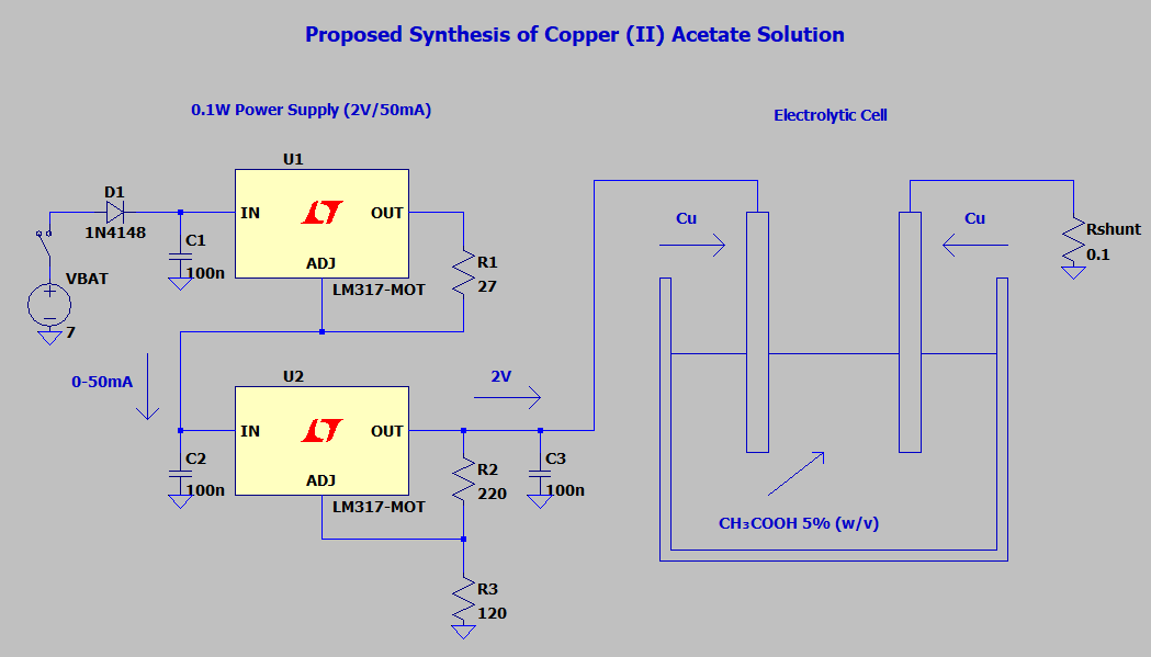

I'm cooking up some electroplating experiments but I'm having trouble understanding the basics. My goal is to produce a fairly large quantity of Copper (II) acetate solution from household vinegar and electricity. A common DUI recipe calls for hydrogen peroxide which is a costly reagent. A previous set of experiments suggest the following method is feasible as I obtained what I presumed to be Copper (II) acetate crystals upon evaporation of the solution with the characteristic reflective dark blue colour.
Given the conditions in the schematic, I'm trying to answer the following questions:
1) What chemical reactions occur? Specifically, what are the reactions at the positive and negative terminals as well as the overall reaction?
2) What are the upper and lower limits for power dissipation of the circuit? In other words, how much power is needed to provide the activation energy to drive the unfavorable reaction? Likewise, what is the effect of excess power? (side reactions?). In this particular setup I'm able to independently control supply voltage and current adding some degree of control.
3) Other comments on the setup? I have a semester of college chemistry so please keep that in mind as I'm trying to understand the limits of the experiment as I have constructed it. It would be helpful if you could talk about the most important variables that I'm not currently controlling for.

The power supplier is very small. I would exchange the 1N4148 to 1N4007.
The anode has to be copper, the cathode carbon in the cell.

1. For a single electron electrode reaction to produce one mole of substance you need to run 1 mole of electrons through the electrode - that means 96500 coulombs (so called Faraday's constant), or 96500 seconds of 1 ampere current (google Faraday's laws of electrolysis). Compare that with the output of your power supply.
2. As long as the voltage applied is too low no reactions take place, what happens later depends on the voltage applied. It can be predicted using standard reduction potentials and the Nernst equation.
3. In your setup I would expect copper to be dissolved on anode and deposited back on the cathode, so no net change in the amount of copper present in the solution. To dissolve copper you need to reduce something else on the cathode, won't be easy (for the reasons signaled in 2.)

Thanks, I think I understand what is going on. Your reply seems to prove my null hypothesis which is my original experiment dissolved the copper by some other means. I asked my teacher about the mechanics and he gave me this hint:
I put this together and came up with a new experiment:
