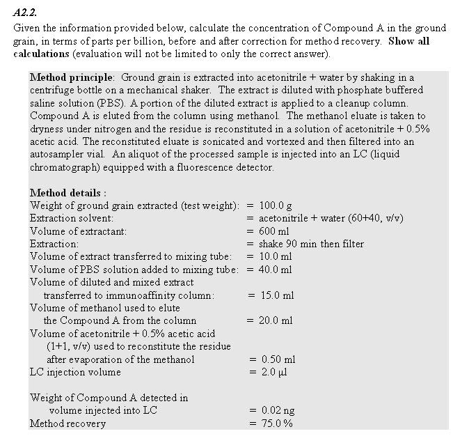

I just can't seem to wrap my head around this for some reason.

In order to solve this problem, you have to build a series of equations, made up of conversion factors, that are detailed in the various steps of the problem.
Useful hint:  Don't scan-n-post a complex question like this.  Attempt to write it out, on scrap paper, and see what bit of info is needed, and when.  See if you can type out a question on this forum, that's built up of important parts of this question.  We'll let you know if you're getting close.  Or you can ask us for one specific problem that you're having with the question.

Well, where to start would be helpful. I just get overwhelmed with the information given, and I'm unsure of what values to take from it. I don't know what I need and what I don't need.

I know you're overwhelmed, but you've let the complexity of the problem dazzle you, and you've just shut yourself down.  If I was at work, and someone said, "Here you go, do it now,"  I'd be a little ticked off too, this is the sort of thing you have to work at, over time, to solve.  Look at it this way:
"Ground grain is extracted into acetonitrile + water by shaking in a centrifuge bottle on a mechanical shaker"
"A crushed ore sample is digested with hot nitric acid by vortexing in a quartz extraction tube in a Vortexicon-2000"
Those two statements above, mean, essentially nothing, to a problem like this.  They are exactly the same, yet totally different.  Many statements in your scan add no useful information.  It is your job to start this problem, by writing on paper or typing in a clear question.

What is the question, that the problem asks.  How much raw material do you start with.  How much analyate do you find.  How much is the raw material diluted/concentrated at each step.  You've let it confuse you, but it is a lot more simple than you give the problem credit for.  Can you write anything along those lines for us?
Look at my made-up example above.  Digest the text into simple dilutions and concentration steps.  The question starts and ends with numbers -- turn the descriptive text into numbers.

Well, it wants the concentration of compound a in ug/L.
I'm starting with 100 g of raw material, or, 1.0 x 10 ^8 ug.
I find 0.02 ng from 2 uL of sample injected.
0.2 x 10^-7 g from from 0.002 ml of sample
0.00001 g/ml compound A
Diluted: 100g diluted in 600 ml= 0.167 g/ml
Then 10 mls of that is taken and diluted into 40 mls of buffer. Now, is this where I do a C1V1=C2V2 equation, or, do I not care about that?
If so, then, (0.167)(10)= C2 (40)
               C2= 0.04175 g/ml extract
I don't quite know where to go from here. I don't even know if I'm doing it right.

Sorry, scratch that, the C1V1 equation should have had 50 as a final volume.
giving me 0.0334 g/ml

You can do it that way, but for me, C1V1=C2V2 is best reserved for simple, one step dilutions, but go ahead if it works for you.
I like to think of a problem like this one in terms of :
100g/600 ml*10ml/50 ml*15ml ...
Do you see how I got those numbers?  Try it out, on some scrap paper.

Yes, although I have to admit, I didn't think the 15 ml part was needed.

This is one of those problems that adds more information than necessary for the actual solution, but I still think it's important to understand the procedure by translating what they said in technical jargon into practical sense.
It's a good exercise.  For me, before I begin a problem like this, I don't pay any attention to numbers.  Rather, I try to translate the basic procedure they're doing.  "Add this"; "dilute that"...etc.
Then I refer back to the numbers given and insert those into the necessary calculations given the question.  Translating the procedure can really help you dispose of excess information when determining the actual solution.

Exactly, but the O.P. should have noticed, unless the class is actually recently talking about multiple extractions and HPLC sample prep and fluorescence quantification, that the whole question had to all be a trick, and it was to chip away at the monster question, a little at a time, until it was broken down into the simplest elements  -- something similar to something the class had done recently.
That's not to say the question isn't pretty cool, taken as a whole.  Such procedures are done, in quantitative analysis.  Someone on these boards will often as for an extraction or analysis procedure, so this is a great example of the bridge between sample prep and real numbers that answer a question.  Sometimes in industry we're called on to work out the math and program the HPLC's integrator, so that a meaningful value related back to the original sample and outputted.
