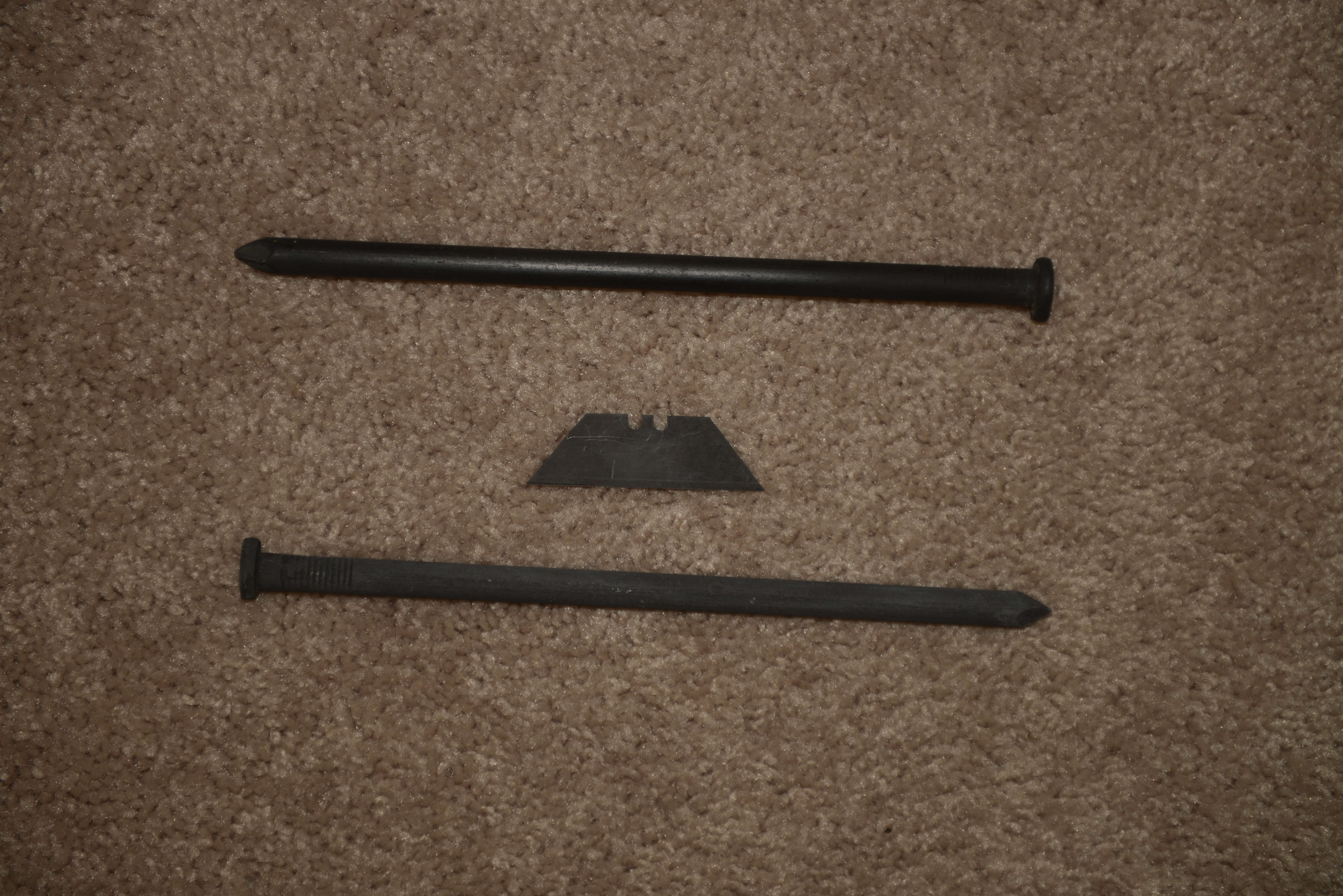

Every time i try to post with an embedded image with or without IMG tags the post does not go through...

This one:
http://www.magicmrv.com/Pictures/DPR/blade.JPG
That I resized and attached:
Hey, I'm not judging.  I just like to shoot straight.  I'm a man of science.

Thanks for your help. I'd never figure out what was bugging it down.
Here is the funny part: that 2MB image is the reduced size version. Just checked the file on cameras card and the original jpg is 17.3MB.

It's made with metallic Mn solution (bottom nail and blade)?
It looks thin and uneven, even nail. Previous nail with metallic Mn looks better.
But how does it looks when it's wet? Imo when it's wet you get best visual info.
If i'm not mistaken proper thickness Mn coating is only in bottom left corner of blade 0.5mm x 15mm strip.
This is almost the same solution with metallic Mn as was used on previous nail. Actually this one has more Mn dissolved, 1g/L. The image with the blade is before oiling, so it is grey-ish. oil makes it darker almost black.
Here is a side note: the digital cameras will alter colour depending on lighting conditions (energy spectrum of incident light). White balance is meant to compensate for it, but does poor job. That is why i am including the black oxide coated nail to serve as a "true black" reference point in every image.
These images were straight out of the tank after they were rinsed in water and allowed to dry the goal was to see if the blade will receive phosphate, which it did. Still need to play with cooking time, this was 30 minutes., iron content and pH to optimise this bath. The purpose of this bath mixture was to see if darker coating can be achieved using metallic Mn than using Mn-Oxide; which it did, confirming that Mn-Oxide as a source of Mn, may be lacking in its capacity as Mn donor.
